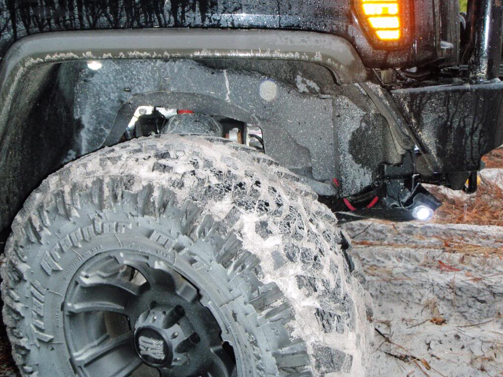

I'm running the Trail Grapplers (35" on 17" Revolvers) on my "T" with a Rancho lift (needed on the smaller Hummers, lol) and they have handled well in the sand snow and mud so far. Hoping to test them out in April at Rausch Creek . Would love to see them on a duece, post up some pics as soon as you make a decision and get them mounted.
