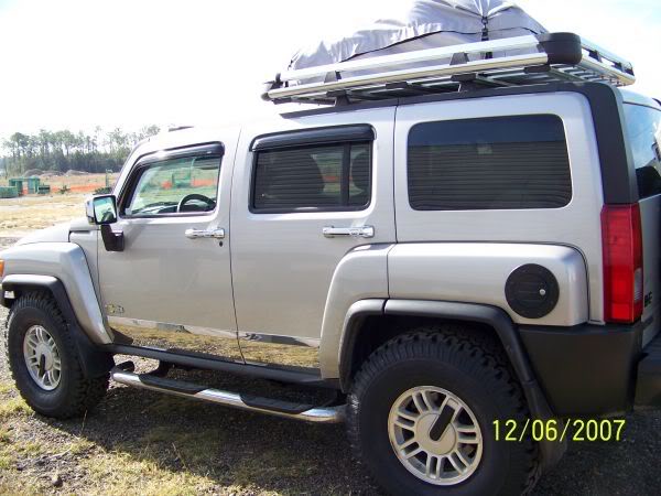

1 Attachment(s)
I've been running BFG315/75/16 AT KO's on the stock rims with absolutely no problems at both highway speeds and off road, thoughI did have to trim the inside of thefender flares I had added (but this was with an FULL load - completely stuffed inside, full roof rack, and a hitch-haul on the back).
Attachment 20195
