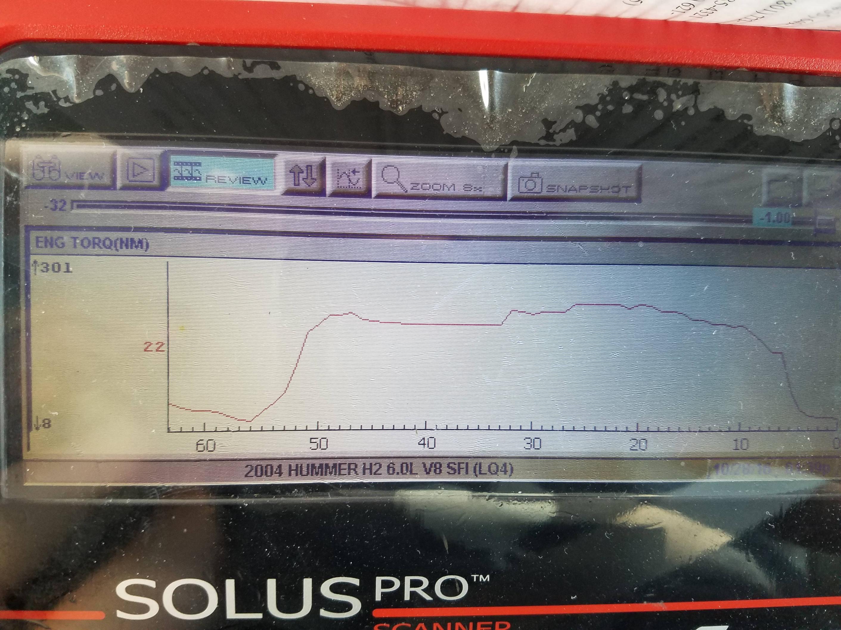

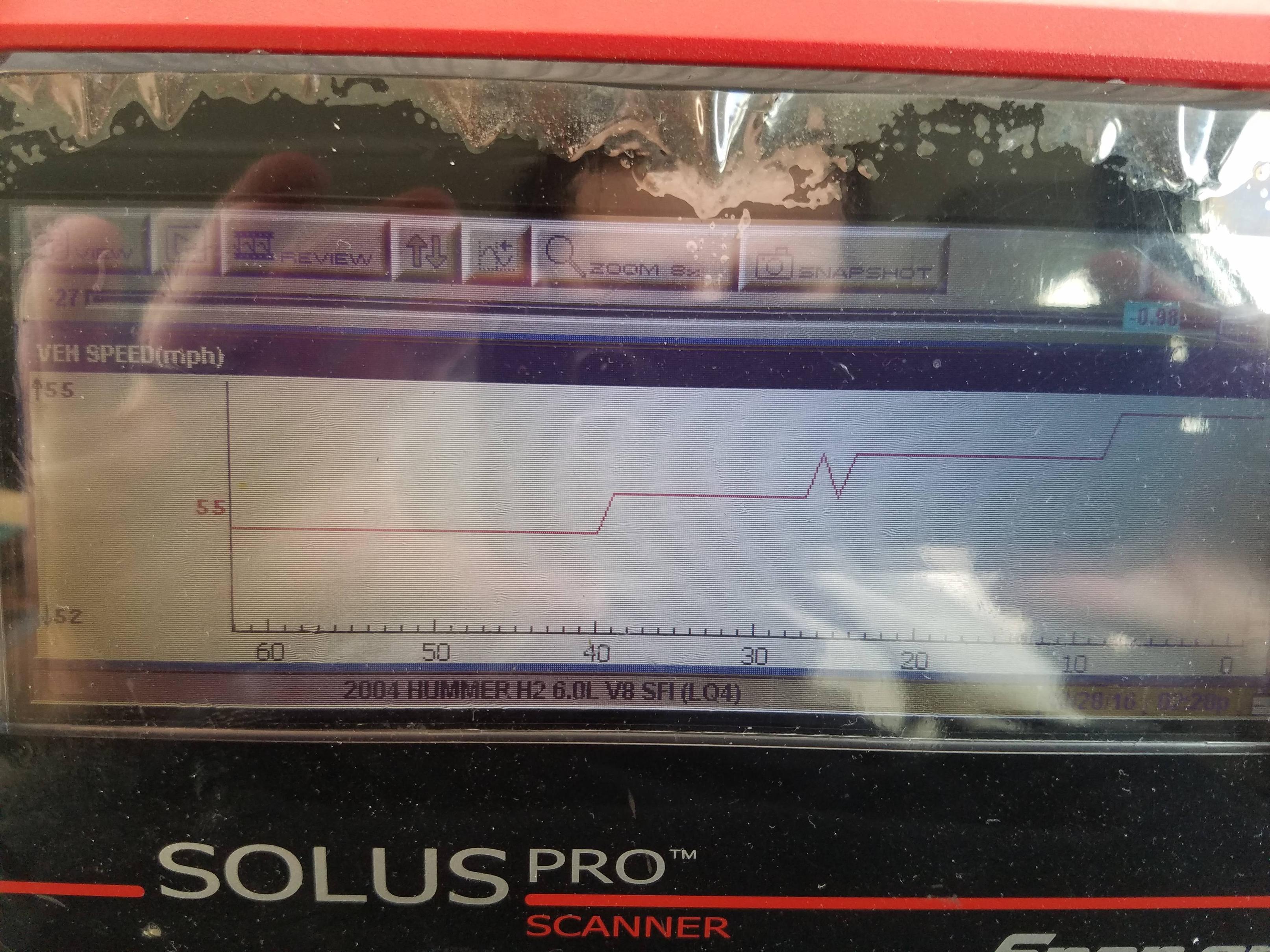

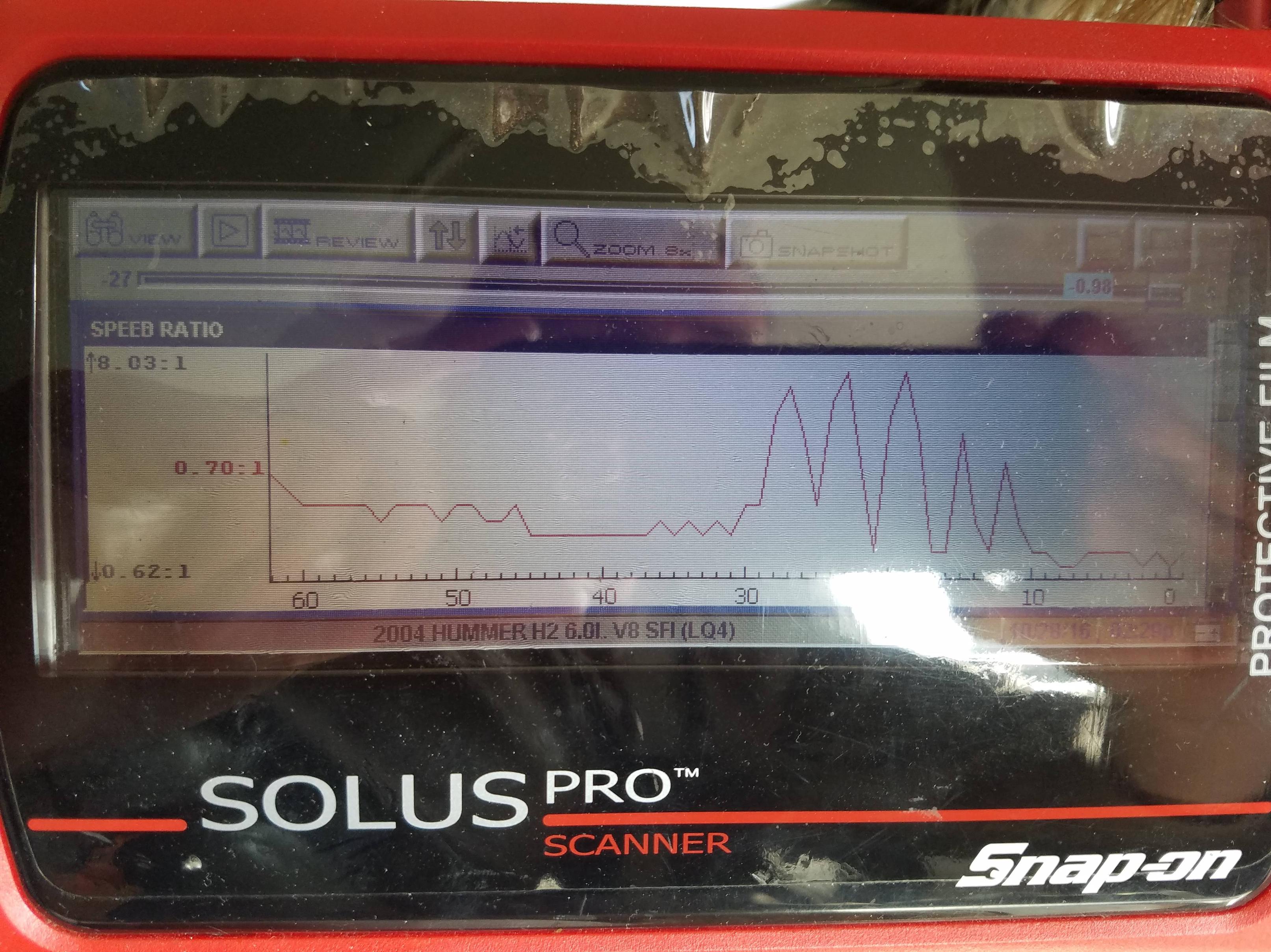

DesertDog Oct 29, 2016 05:49 PM
9 Attachment(s)
So i captured some PID data from the Solus and ill post a few and you can clearly see at the 28 mark on the timeline is when the surging happens. it was captured while driving steady at 53 mph.

HUMTECH Oct 29, 2016 07:43 PM
It would appear you have bad connections at transmission connector to me. Odd spikes in data readings especially on trans fluid temp readings. If someone has been doing diagnosis on this and used improper test pins in connectors I would suspect pin grip connectors are expanded and not making good contact(hot dog down the hallway) Or connections at module same thing.
HUMTECH Oct 29, 2016 07:48 PM
You could try dielectric grease in transmission connector and see if that helps. It may or may not.
