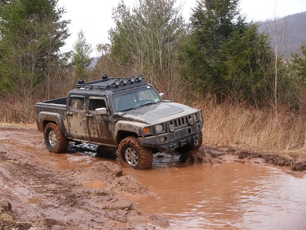

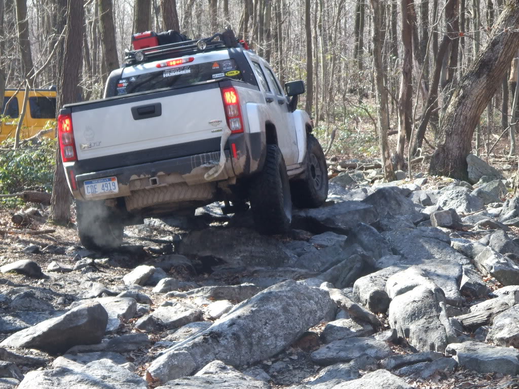

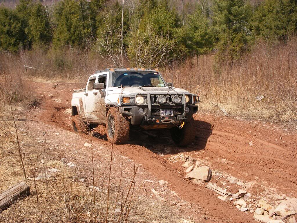

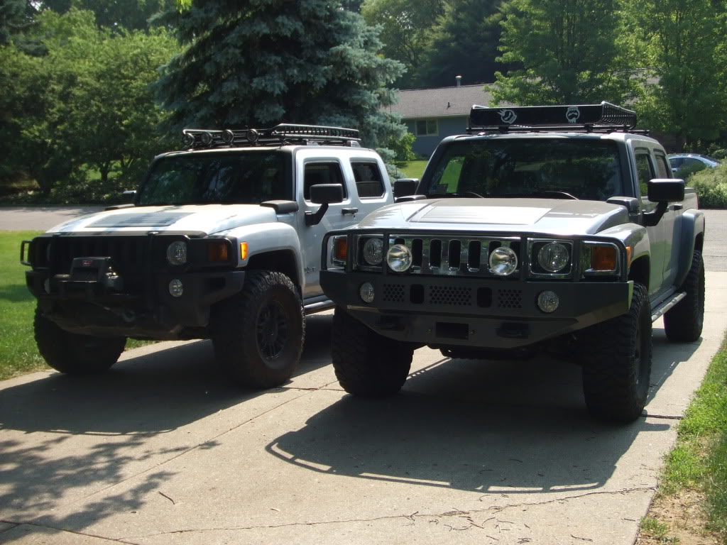

10 Attachment(s)
Exactly what Beit said except the Adventure package also comes with the VERY Important 4:1 transfercase! :D
Our 09 H3T has the I5 and a manual transmission with lots of extra weight (bumper, winch, Sliderz, 315s, UCP, rack, etc) and Mr. "T" moves out pretty darn well and gets a decent 13.5-16mpg depending on who is driving (I get 13.5mpg!:D).
If you plan on ever wheeling it get the Adventure(I5) or OffRoad(V8) package. The front/rear lockers and 4:1 T-case make a huge difference in the ability to get over obsticles with the longer wheelbase.
Don't waste your $ on a "leveling kit". The same height can be gained by a simple torsion bar adjustment and alignment.
Hell Yes they can get dirty (just protect your investment) and haul a ton of stuff too!

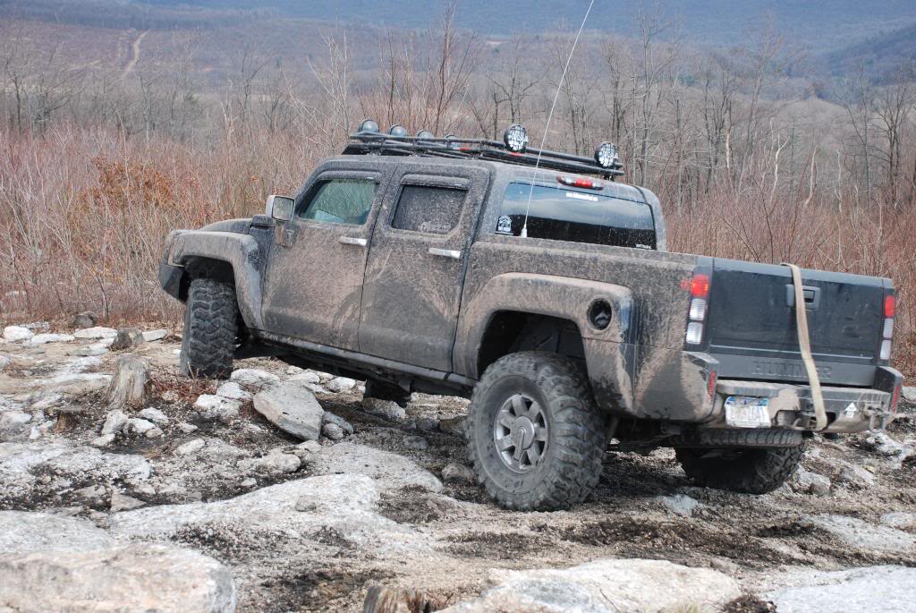

TAINTER Aug 10, 2011 11:47 AM
7 Attachment(s)
More Gettin' Dirty H3Ts!
