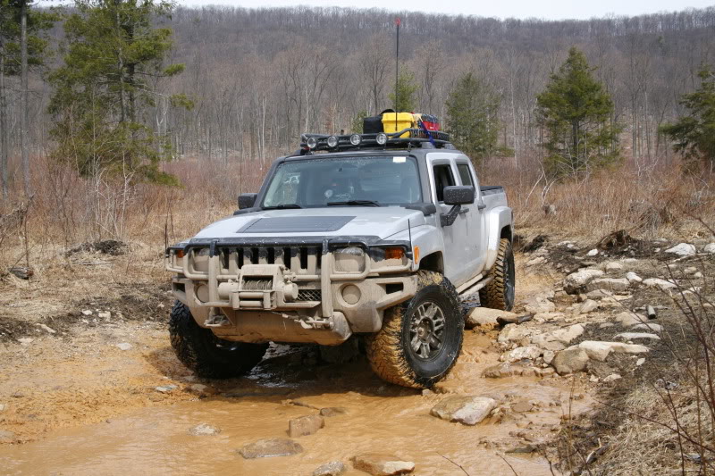

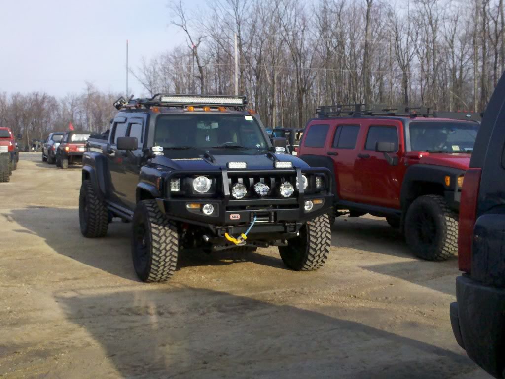

Exactly what Beit said except the Adventure package also comes with the VERY Important 4:1 transfercase!
Our 09 H3T has the I5 and a manual transmission with lots of extra weight (bumper, winch, Sliderz, 315s, UCP, rack, etc) and Mr. "T" moves out pretty darn well and gets a decent 13.5-16mpg depending on who is driving (I get 13.5mpg!).
If you plan on ever wheeling it get the Adventure(I5) or OffRoad(V8) package. The front/rear lockers and 4:1 T-case make a huge difference in the ability to get over obsticles with the longer wheelbase.
Don't waste your $ on a "leveling kit". The same height can be gained by a simple torsion bar adjustment and alignment.
Hell Yes they can get dirty (just protect your investment) and haul a ton of stuff too!

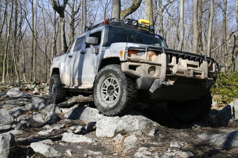

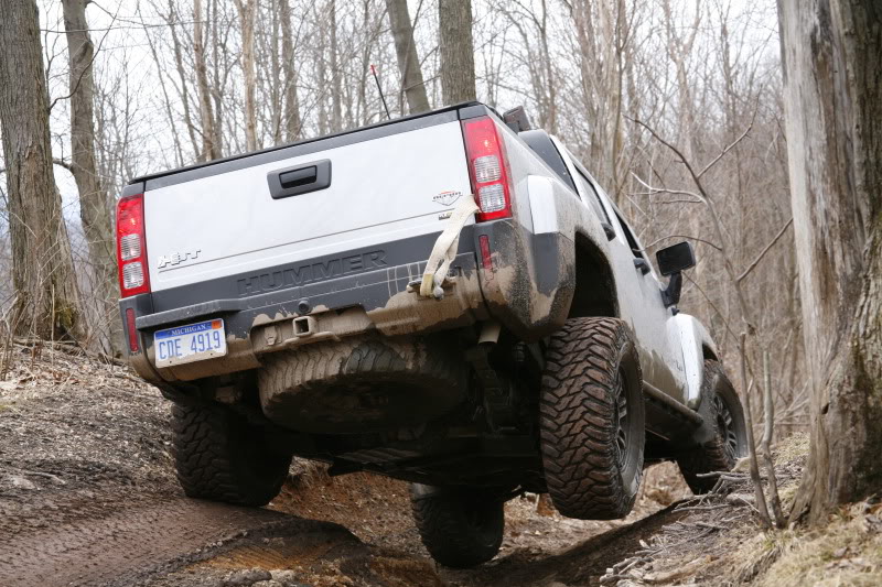

More Gettin' Dirty H3Ts!

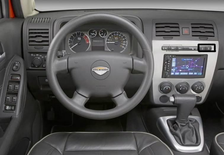

Nope! That T is not an OffRoad/Adventure package T!
The easiest way to tell is to look at the interior shot you have posted. On the 4x4 control panel you will have 2 locker buttons on the right side of the airbag indicator. The OffRoad/Adventure package also came with 285/75R16 Duellers (33") vs the 265/75R16 (32") but some dealers put the 33" on non OffRoad/Adventure package vehicles after the customers asked for the "big tires".
This is just a photo from the internet, I know it does not show the lower switch positions correctly.
