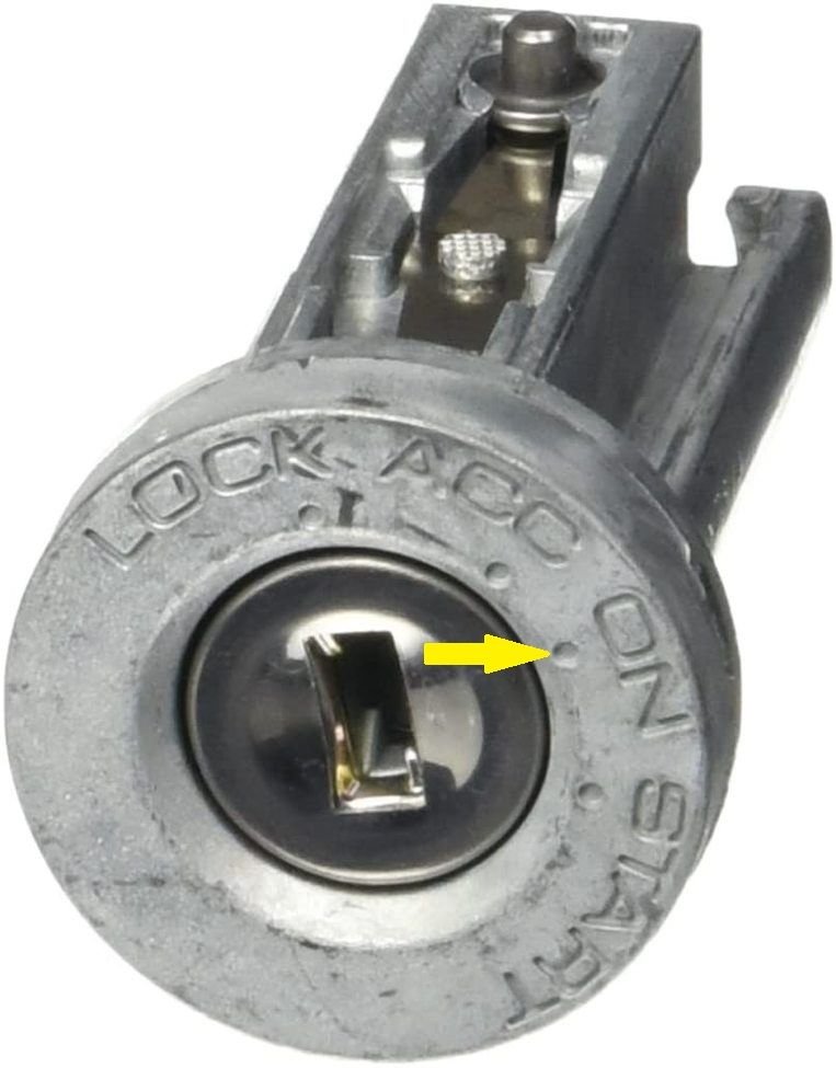

hummerz Sep 11, 2020 05:39 PM
Originally Posted by Alex DjFlaco (Post 377444)
I cant even put my car on the on position to put it on neutral.
:confused: You previously posted the instrument cluster will light up, now you're stating, you can't get to the on position?
THAT DON'T ADD UP! YOU NEED TO GET TO ON POSITION FOR BOTH!
https://cimg9.ibsrv.net/gimg/www.hum...e4959863a1.jpg
Alex DjFlaco Sep 11, 2020 06:34 PM
Yea for me to turn my tires i have to have the car on start position. So right now I cant turn my tires because I can't start the car. I checked to see if it was the battery and its not. Im starting to think its the starter.
