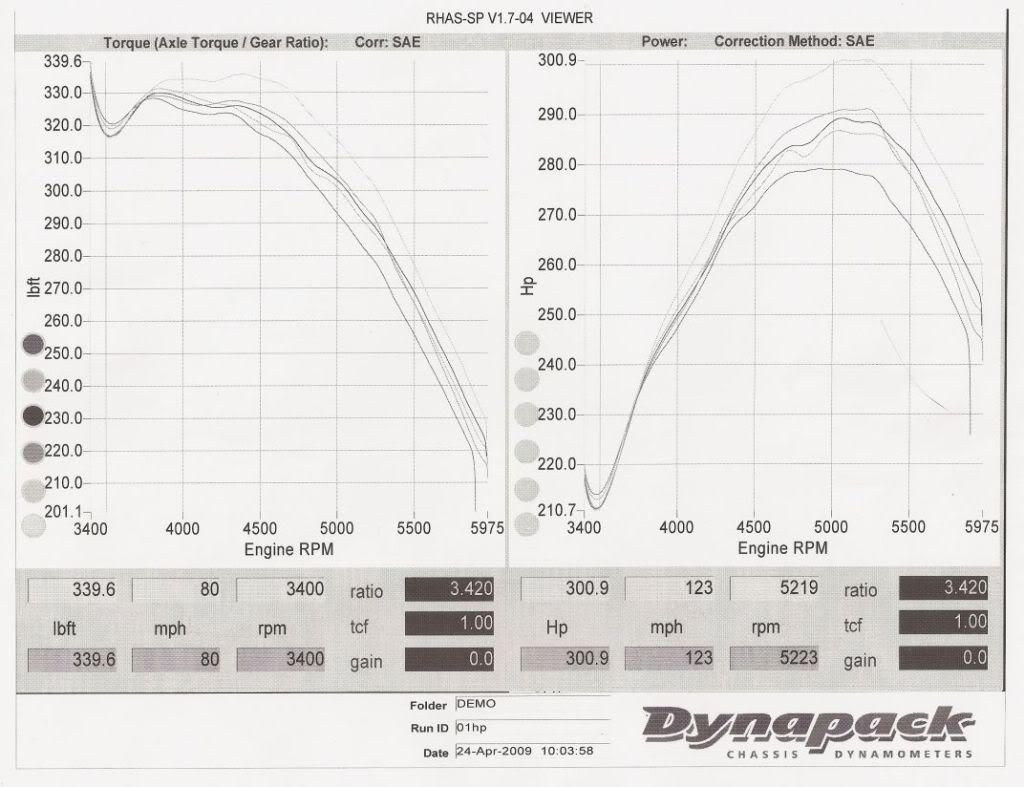

Saturday Job? What's your Saturday worth? Something you wrote also makes me wonder if you are talking about an LH8 H3?
It would appear you are saying a cam is great if you already have: 1) an intake; 2) free flowing exhaust; and, 3) get a PCM tune. That's four mods in all, and the cam itself with the install essentials is under $500.
Pretty hard to get 30rwhp in an permanent AWD/4X4 H3. I did not have any access to an AWD dyno in 2009, so all I could do was compare the same LH8 in a 2WD capable platform.
Here is the #s, stock with zero mods 2WD 2009 Colorado LH8 5.3L as a baseline runs 224 HP and 253 TQ max.
After an Air Doc Intake with K&N filter in the box, PCM tune, Efan conversion, and a performance muffler (nobody made Cat backs or Efan conversions for the 2009 Colorado when our customer ran this test) stock cam. 300 RWHP and 339 TQ.
Pretty much took the flywheel numbers and moved them to the wheels with those mods. The PCM tune controls the fan PCMforless Efan with a patch now, takes about an hour to install the Efan on the 08+s version and costs less than $350.
So my answer is mod 1, 2 and 3 (I'm only including them because you did ), plus...... an Efan conversion ... and spend the rest of Saturday on the boat.
What I was originally getting to was, a cam takes hours and may be beyond simple for many to DIY. The other stuff is easy, take minutes, and for some you do not even get your fingers dirty.

cant tell what the curves are but you can see a slight increase at,,,4500,,,!! yikes,i try to avoid that neighborhood.
my new trip comp gives max readings. rarely see 3000 unless racing to the pizza shop!.
i still see no use whatever in persuing hp in a hummer. off road mods ok but in lo lock u got more tq/hp than u need for stump pulling.

I listed the other bolt on mods because I consider them to "supporting mods" and ensure you get the most out of your rig. That dyno chart looks good, but wouldn't it look better at 340-350hp? You know, since this thread IS about a performance camshaft
What I'm getting at is a cam the "next step" once you have already done the basic bolt ons and still want more without dropping $4500-$6500 on a supercharger or turbo kit..
