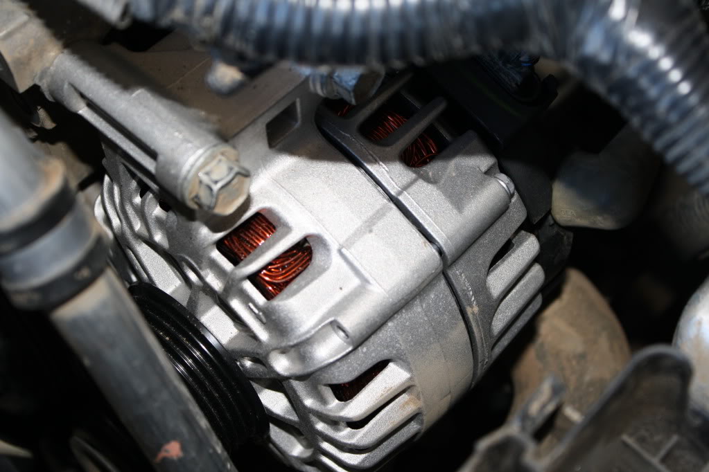

Ok guys here we go.
New alt.

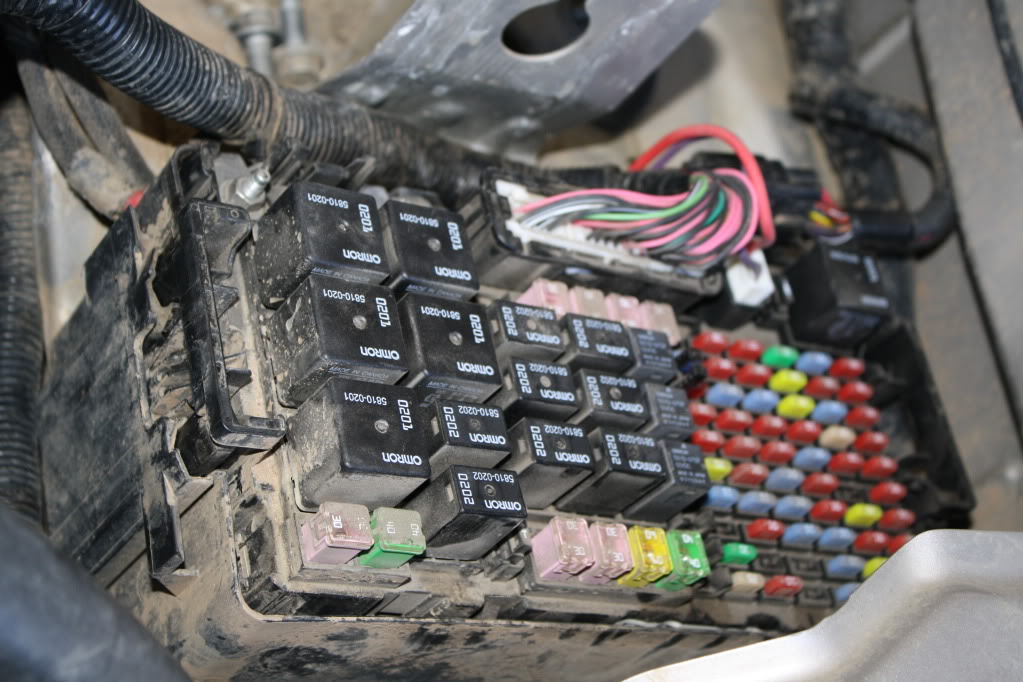

Once you get the alt in and start to put everything back together, there is one thing you need to do.
When you are putting the fuse box back together you MUST put the two wiring harnesses on the fuse box. They take some force(alot) to get them to clip in. If you try to put them in the base and then put the fuse box on, it wont snap into place.
These must snap in to the top first(where all the fuses are).
This is what it will look like if you dont put them in first. Notice the gap on the left side.
Once they are on the box will snap into the base.
Once you do that hook the batt back up, fuel line back together, replace the belt, and put the A/C line bracket back on and go for a drive.

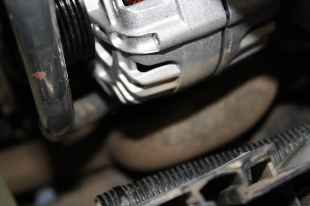

Is that the same exact alt you took out and just got as replacement? Mine is a 145A stock.....
I guess I need more power than most people, so I'm picky about my alternators.
Old Apr 21, 2011 | 10:21 PM
  #26
0331Marine's Avatar
Joined: Jul 2010
Posts: 27
From: Fallbrook Ca as of now
Its the same alternator. The parts store ordered the wrong one and it was going to be another week before the right one came in, so they got me one from the Hummer dealership.
