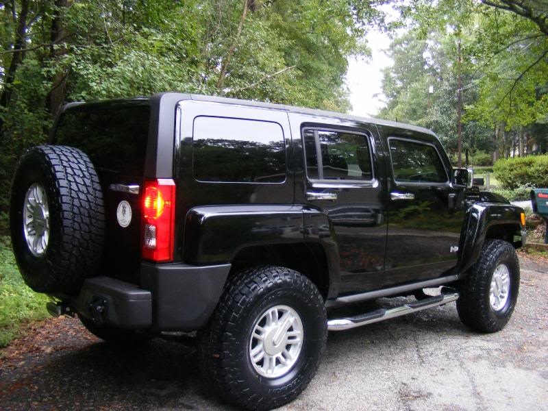

315/75's(35") will fit. I replaced my 265's with 315 Nitto terra Grapplers on my wifes H3(her daily driver) and it rides fine. I did the spare too.
I did crank the torsion bars up a little to level it out but they cleared at stock height.
Attachment 17862
Attachment 17863
Attachment 17864
126Andy Mar 7, 2016 11:02 PM
Why would it not be level if you put 4 of the same tire on if it was level with the 4 you took off? Just asking because they are the same tires that I am going with
TAINTER Mar 8, 2016 06:19 AM
315/75R16 Will fit.
Doc Olds Mar 10, 2016 02:39 PM
T Bar leveling has nothing to do with tires. Stock H3s have the front set lower than the rear from the factory which was to increase fleet fuel mileage and meet safety standards for bumper height alignment in crashes with other automobiles. That is adjustable through the Torsion Bars so the front can be lifted to near 100% level the front and rear.
126Andy Mar 11, 2016 09:20 AM
Thanks for clearing that up. You were talking about putting on the 35" tires and then saying that it had to be leveled up I was just wondering why they would throw it off level.LOL
I went with the 315 Nitto terra Grapplers just yesterday and so far I'm liking what I'm seeing and have no noticable road noise.
