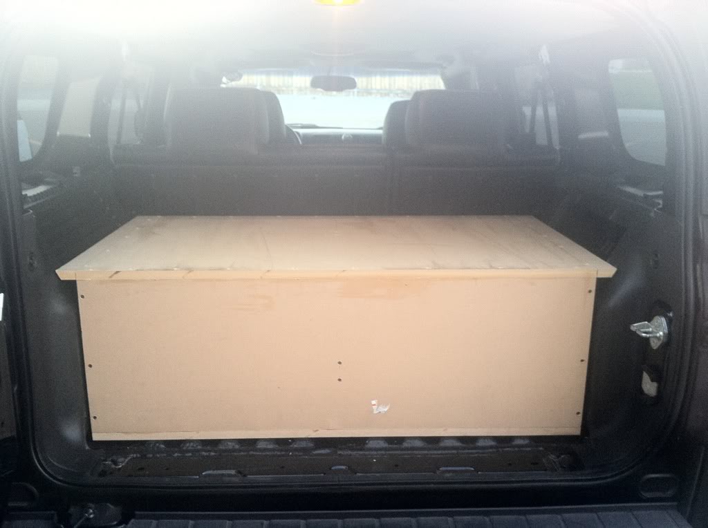

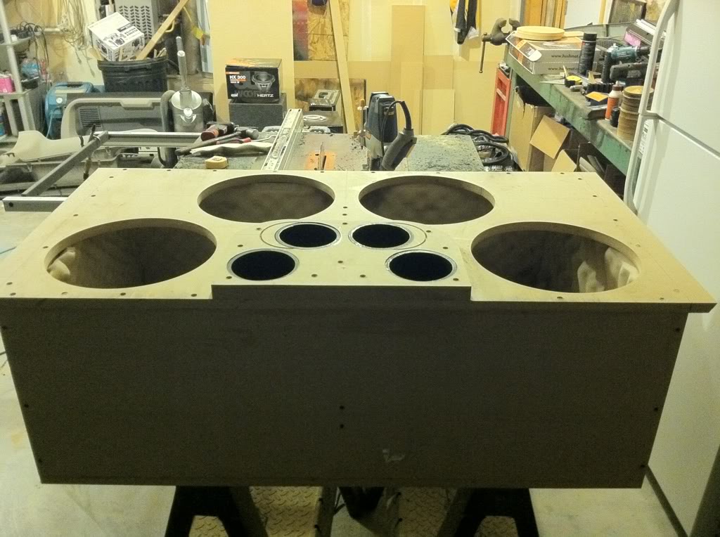

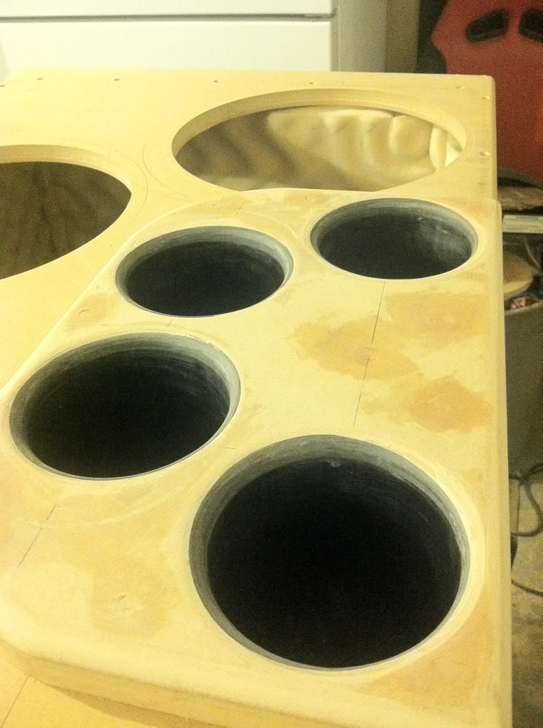

7 Attachment(s)

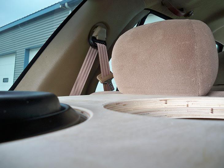

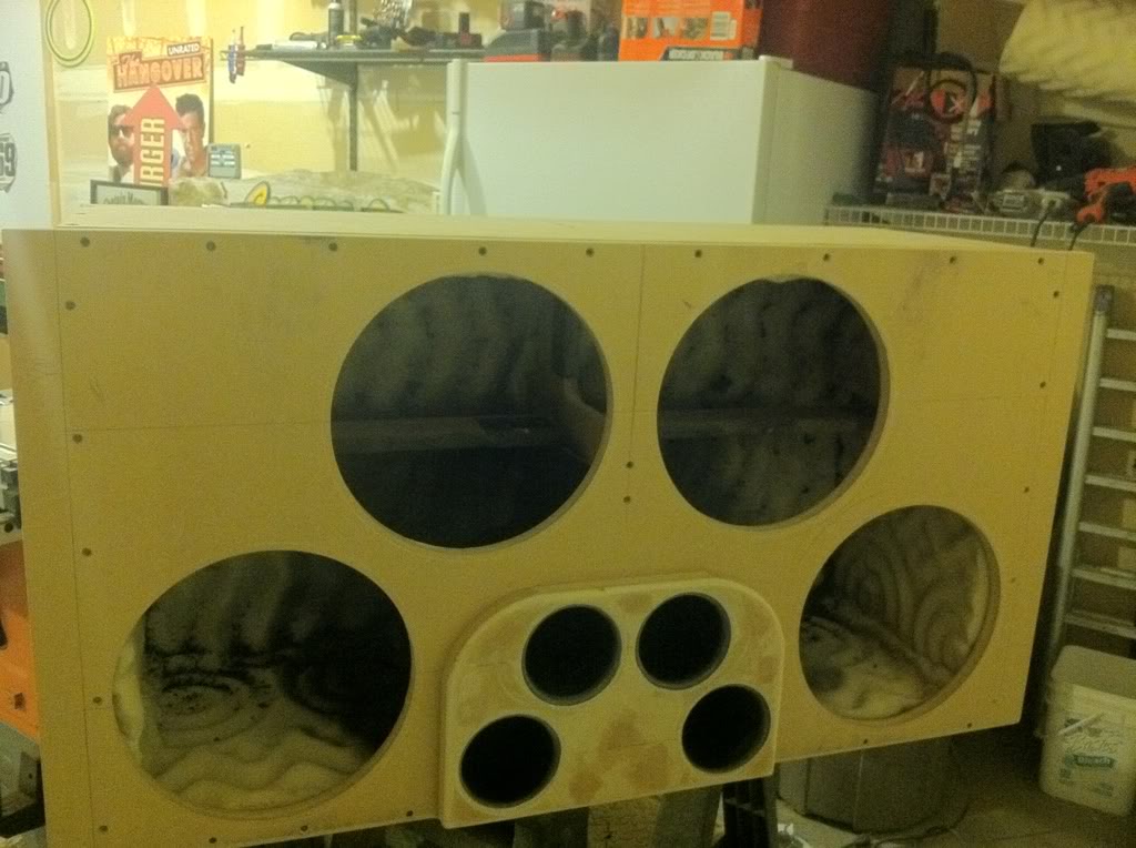

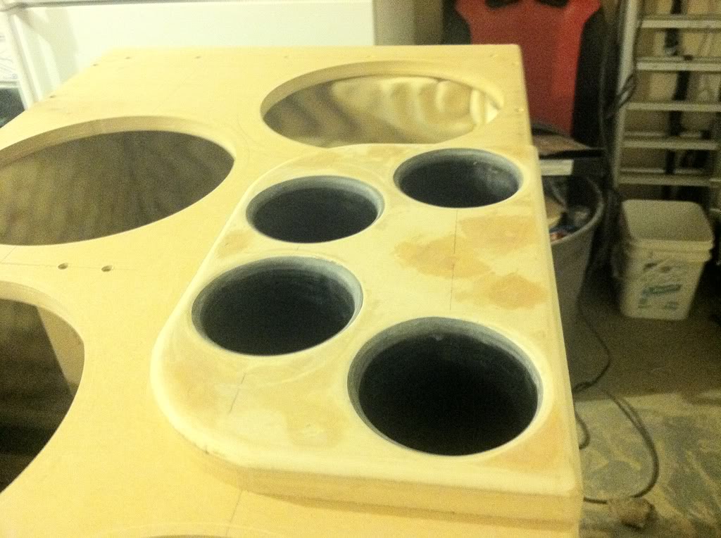

I have a few pics of the starting progression, but its still in the very early stages..
Attachment 15153
Attachment 15154
Test fit
Attachment 15155
Holes cut for subs and ports
Attachment 15156
Ports installed, routtered over edges, and did some bondo smoothing
Attachment 15157
Attachment 15158
Attachment 15159
Still a ton of work to be done. Will update as I go. What do you think so far?

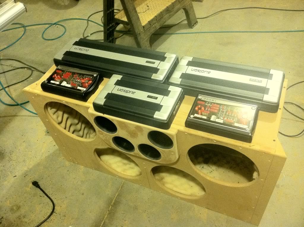

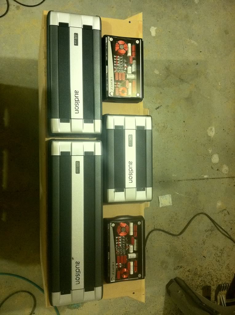

kalen427 Oct 10, 2011 09:22 PM
2 Attachment(s)
Laid out the amps and crossovers to see what it will all look like before i build the rack mounts. Aren't those crossovers gorgeous? :D
Attachment 15151
Attachment 15152

Build looks great. Audison/Hertz/Conection make great products. Port area seems a bit small but then again, I spent my years mostly around DB Drags Bass Race & IASCA Bass Boxing. I would have expected it to be tuned slightly lower also for SQ. Look forward to seeing the finished results. I got a bunch of stuff I want to do with the H3 (audio wise) but I have took a little break from CA and been into trail riding and off roading lately. Once the H3 gets built up, I will start on the sound system. Unfortunately with all the gear in my H3, there won't be enough room for what I am used to.

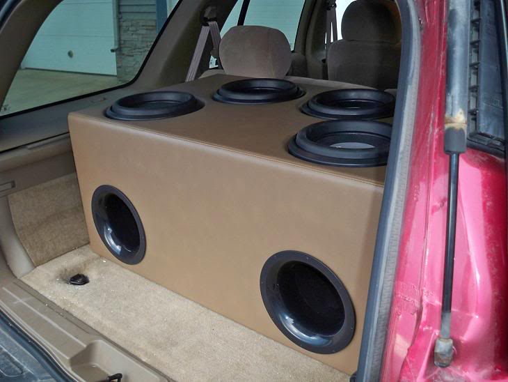

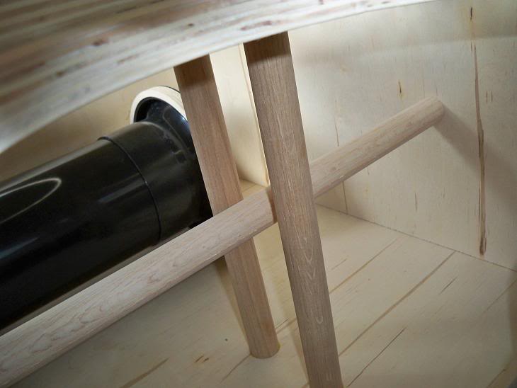

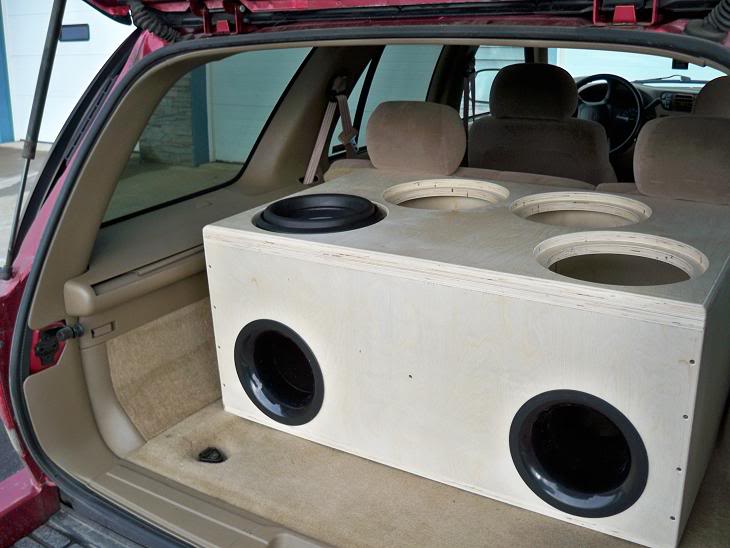

SundownAudioNY Oct 11, 2011 05:18 AM
11 Attachment(s)

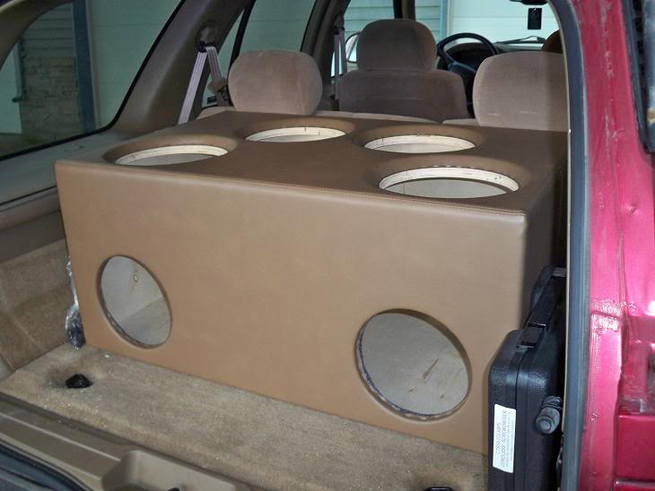

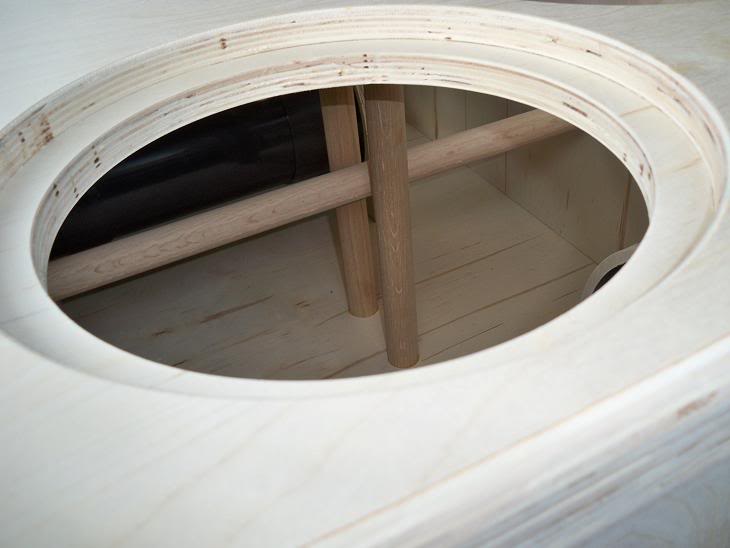

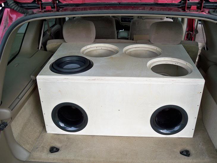

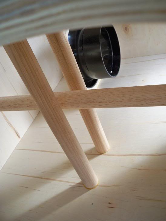

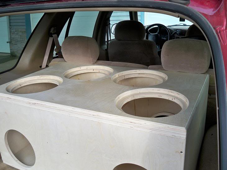

Hope you don't find this as thread jack but I thought I would share (if it is, let me know and I will remove it). Here is a box I built for my blazer right before I sold it. Box was built for daily driving and ocassional bass racing.
3/4" 13PLY Birch
Double Layer Baffle w/ Second Layer Flush Cut
1 1/2" Birch Dowel For Bracing
6ft^3 @ 35Hz After All Displacement
Dual 6" PSP Aero Ports
Attachment 15140
Attachment 15141
Attachment 15142
Attachment 15143
Attachment 15144
Attachment 15145
Attachment 15146
after upholstery
Attachment 15147
Mock up w/ ports & subs
Attachment 15148
Attachment 15149
Done
Attachment 15150

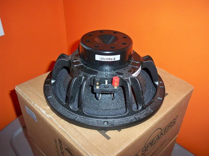

SundownAudioNY Oct 11, 2011 05:36 AM
11 Attachment(s)
Few more pics, unfortunately the build never got completely finished before the vehicle was sold.

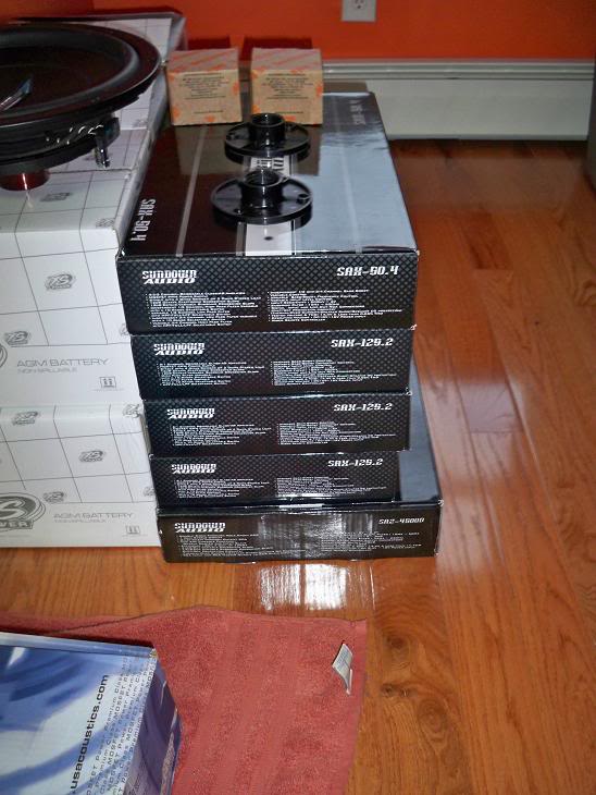

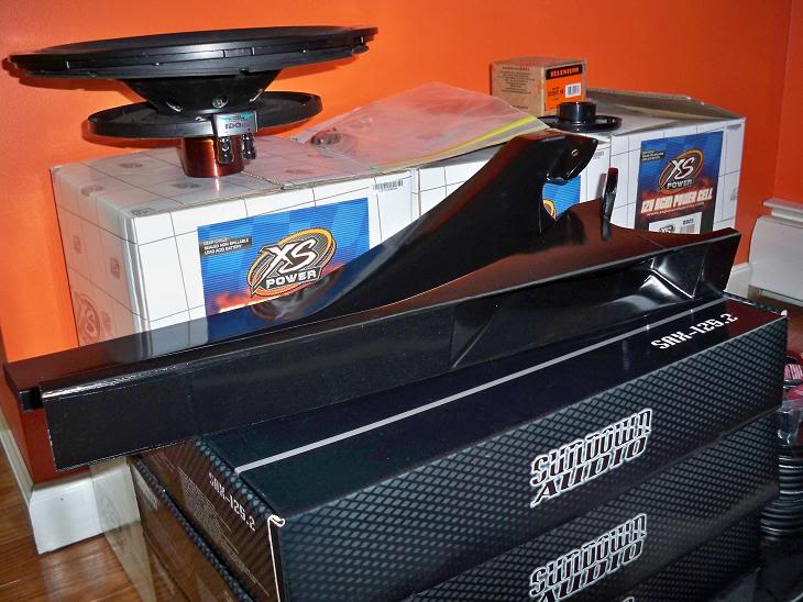

Got Power? XS POWER
Attachment 15129

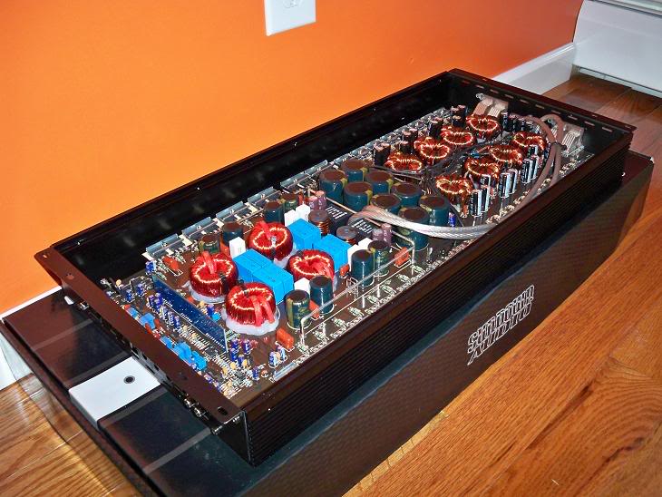

Amps! Sundown Audio SAZ-4500D & Three SAX-125.2's for mids & highs
Attachment 15130
Attachment 15131

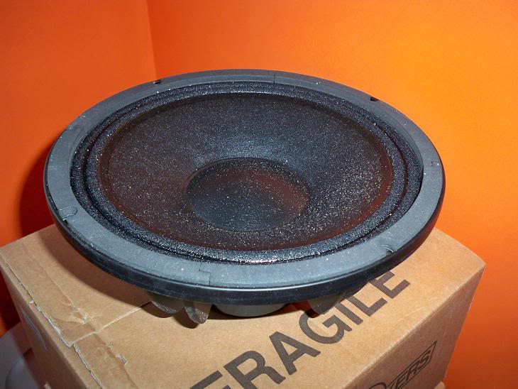

Someone say mids & highs! Pro Audio 10" B&C 10NW64's & Selenium D2500Ti-Nd Drivers (same drive as the Image Dynamics CD Ultra) w/ Image Dynamic Mini Bodies
Attachment 15132
Attachment 15133
Attachment 15134
Attachment 15135

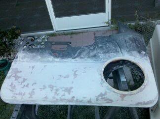

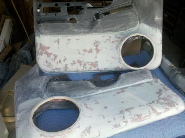

The fiberglass door panels that never got used, still sitting in my garage :(
Attachment 15136
Attachment 15137

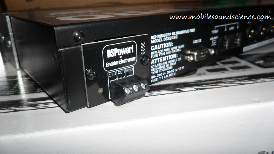

Processor - Behinger Pro Audio DCX2496 w/ DSPower 12V Power Supply Mod
Attachment 15138
Attachment 15139
