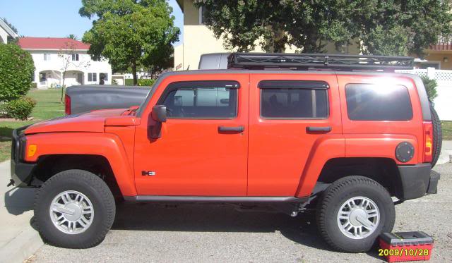

I have attached some pix of an H3 with a body lift:
H3 w/265s before 1" Daystar Body Lift:

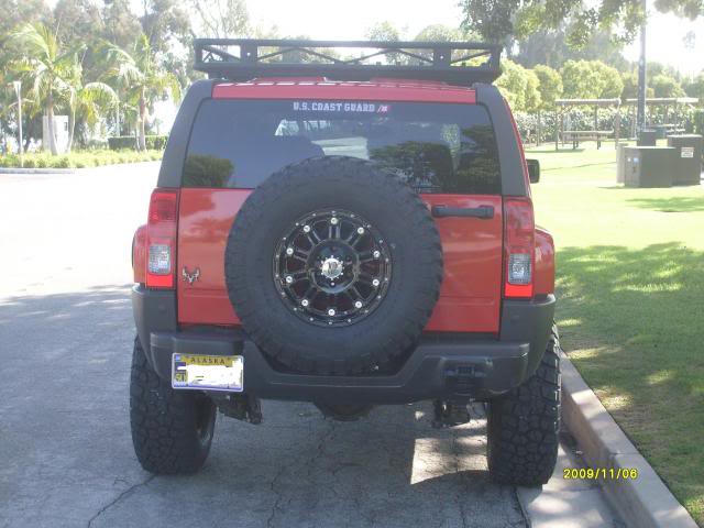

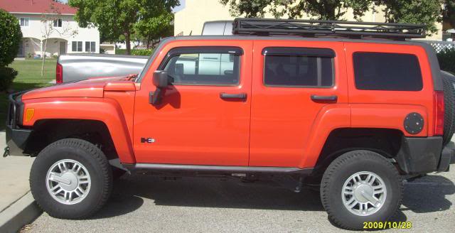

H3 w/265s after 1" Daystar Body Lift:

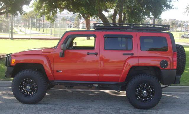

Same H3 with 315s after 1" Daystar Body Lift:
Same H3 with 315s after 1" Daystar Body Lift rear view, note the slightly larger gap between the rear bumper and the rear door/gate (no difference in the side plastic pieces):

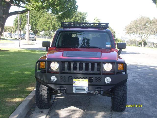

Same H3 with 315s after 1" Daystar Body Lift front view with a BA bumper:
