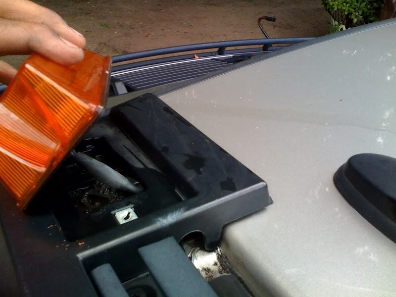

your right mike...and I just wanted to correct myself here even tho the drains are dripping water it IS the drain...upon more trial I again poured water again on the rails it leak and n by the drain holes it leaked didn't last time so headliner is being carefully removed just on the end to see if it's a clamp not tighten...and also I took off the corner orange lamp n poured lil water and no way for water to enter the h2 like that because even with the light off it drain outside along the hard plastic liner into door jam to the street....will keep y'all posted

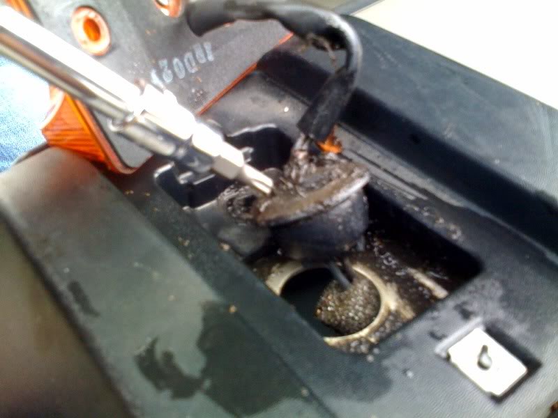

CONCLUSION:
In the start where I open the sunroof and poured water on the rails that was a mistake its only natural pouring it on the rails will cause the water to drain to the left over the onstar mic and down the corner on the hand bar..the rails are slightly raise and water should really in no way ever get in on them is the roof is closed(my mistake..unless your drains are really clogged and there is build up in that area), which lead me to thinking even thought the sunroof drain wasn't clogged that it has to be somewhat clogged or has a hole where it connects to sunroof roof leading it to drip by hand bar while its raining(wrong again)...after removing hand bar, visor, rubber seal around door and sunroof I pried the the headliner down only to figure out it from the corner orange light that sits right above drivers head(as seen in my pics below)..a simple grommet need changing or sealing, thats it. thanks for all the help.

Driver's corner marker light is probably the most common place for a leak and is the first place you should check with any type of overhead leak as well as water ending up on the drivers side floor. I believe the grommet works loose over time from the vibrations of closing (slamming) the driver side door. Pull the grommet up and apply a good coating of Adhesive grade RTV and reseat the grommet in the hole.

glad you found it and thanks for the pics of the repair ,i would also rtv the marker
light just to be sure ...mike
