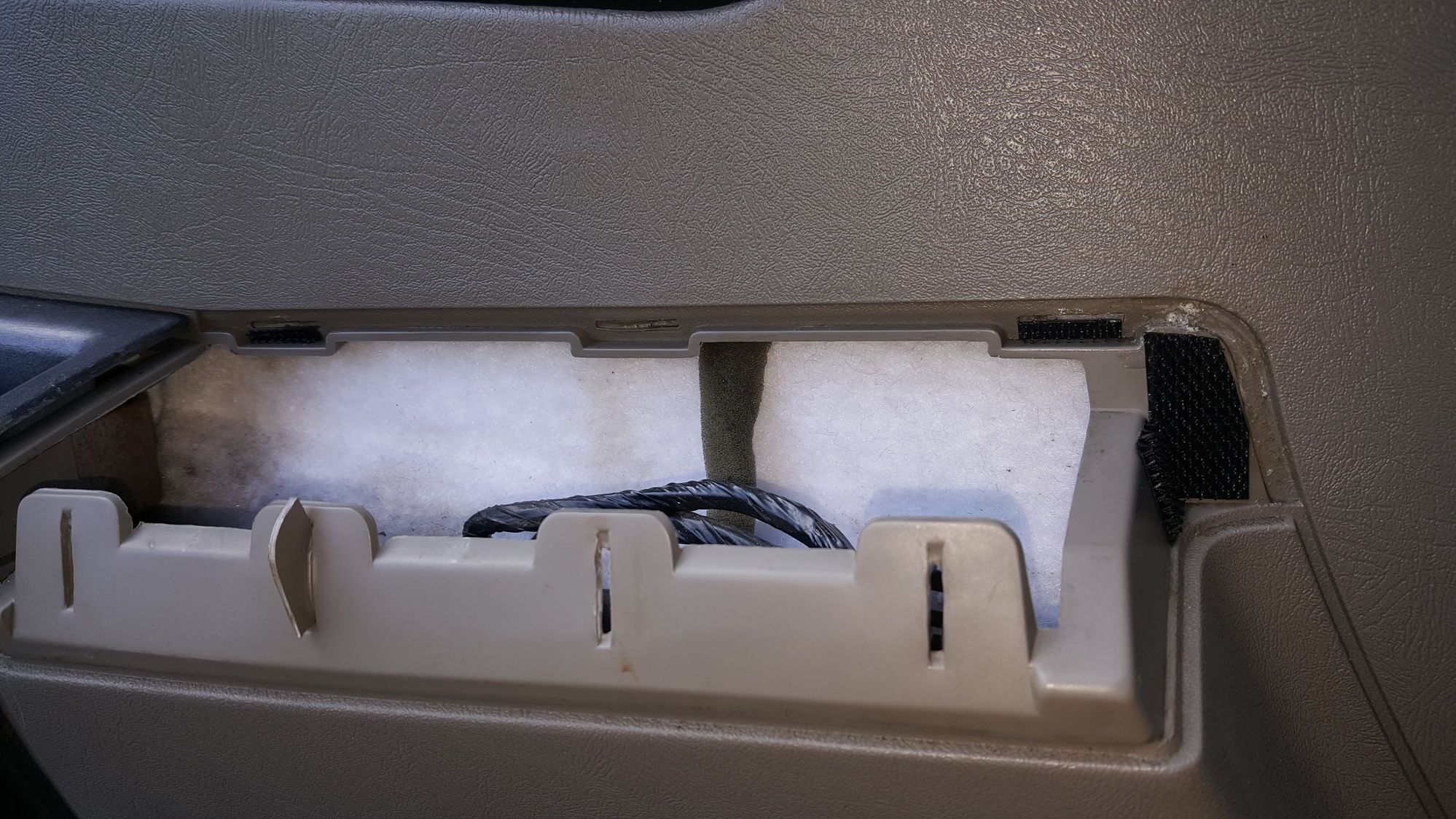

The knucklehead who owned the truck previously broke literally every single clip, then glued the master switch down. Not only does this look terrible, but it makes it difficult to remove it if I needed to in the future. I removed the glue and the master switch cover and have been brainstorming a good way to fix it. My wife thought of the ingenious idea of using magnets with adhesive backs. My only question is - would magnets cause any ill effects on the electronics in the door panel? Or should this be a safe method? I tried using 3M Velcro but it wasn't sticking well enough.

I think I'm going to try industrial strength Velcro instead of magnets just to avoid any potential problems with magnets and electronics. The first time I tried 3M dual lock Velcro and it just doesn't work for this type of situation. I'll report back with pictures later if this is successful. Seems like this must be a common problem considering how easy it looks to be for someone to snap all the master switch plastic tabs off

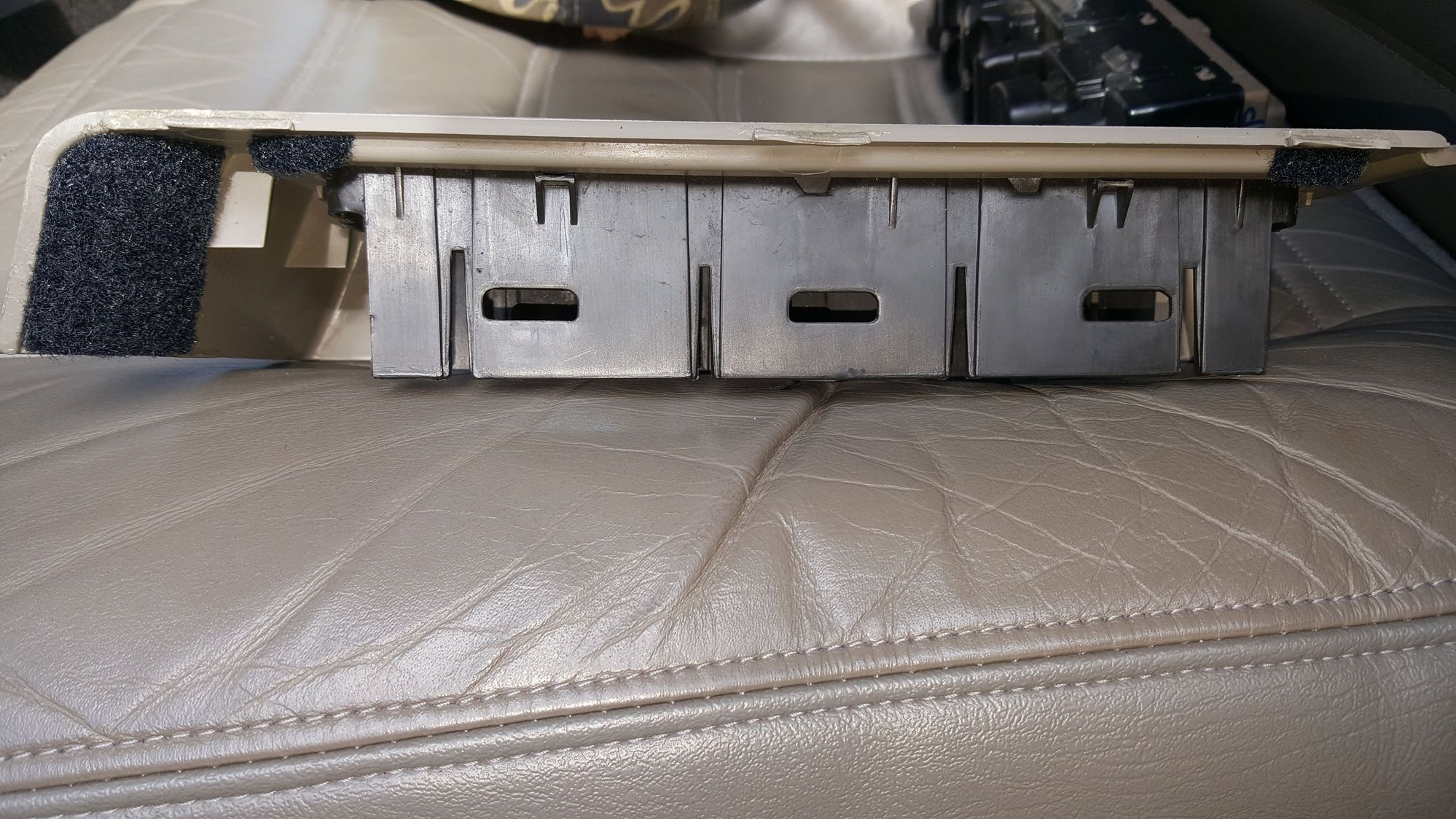

What doesn't sound OEM? It is the original master switch cover on the door panel. The previous owner just broke every single clip removing it. I'm trying to think outside the box to fix it without using glue like they did. Velcro was not strong enough to hold it. I am going to try using magnets this time. Hopefully it doesn't cause any problems using magnets in the car.
Here are some photos of when I tried to fix it with Velcro (it didn't work because it wasn't sticking well enough)

Oh that sucks. I thought you were talking about the black surround that goes around the switches. That previous owner was an idiot, the switch pack easily pops out through the top using the black surround NOT the door trim.
Truthfully I would 2-part epoxy that piece of the door panel back on after properly prepping the areas to accept epoxy and if you need to remove the switch pack just pop it up and out against that piece you epoxied in. That's how I've always taken mine out. Eventually that black bezel will break, mine has but it doesn't affect holding the switches secure and new bezels can be had for around $35.

Yeah - I actually do not think that outer part is intended to be removable, ever. The only way to remove it is to break its tabs off as the factory melts the tabs into place. The switch and the black part around it are removable. I'd use some 2 part epoxy and permanently reattached that bit. Then in the future if you need to remove the switch or its black plastic part that it clips into, just remove those.
They might be on some years though. GM made a few slight changes like that with other bits like the grab handles. On a 2003 and I think 2004 the grab handles on the door panel are not able to be detached without damage but on later years they can be easily unbolted and removed. Some bits have the plastic tabs/clips melted to the surrounding plastic while other bits do not.
