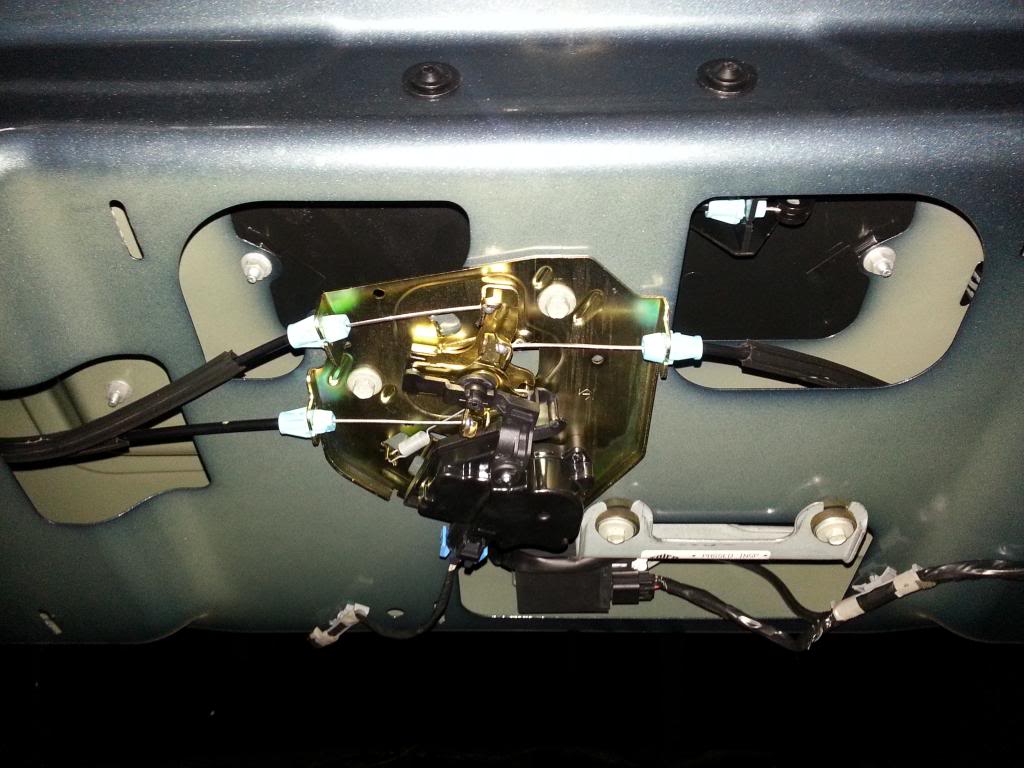

LoJac963 Jul 18, 2015 04:37 PM
1 Attachment(s)
This is the only pic I have, it's of the actuator and bracket with the cables going to it. You would likely need to replace the actuator portion. It is very easy if you follow the instructions FYR provided.
Attachment 11482

How do
How do i open the hatch to replace it?
http://i40.photobucket.com/albums/e2...225_182248.jpg
LoJac963 Jul 28, 2015 03:01 AM
Luckily mine ended up locking in the open position but if the hatch is closed you need to follow the directions on removing the strap and trying to pop the interior trim loose. You won't get it all the way off but you should be able to pull it forward enough to get a hand down there and pull the two cables to release the locks and pop it open.

flyday58 Apr 30, 2017 09:22 PM
1 Attachment(s)
Old thread, just reviving long enough to thank LoJac for the pic, used it to get mine open on vacation.

flyday58 May 4, 2017 08:21 PM
For those whose rear hatch won't unlock, you can pull the plastic surround out enough in the middle to get your arm in and pull the unlock cable, unless you got Schwartzenegger's arms. Lojac's pic is upside down so the unlock cable will be on the bottom right side if you're sitting in the rear cargo area. It's the top-left cable in the pic. The windshied wiper bracket is at the bottom of the pic.
Once the surround is off the 3 cables come off easily, then 3 10mm bolts and the assembly is off. One torx screw holds the electric lock to the plate. Bought a replacement on ebay for 20 and change and now back up and running.
Thanks again to Lojac for the pic. It helped me figure out how to get the hatch open.
