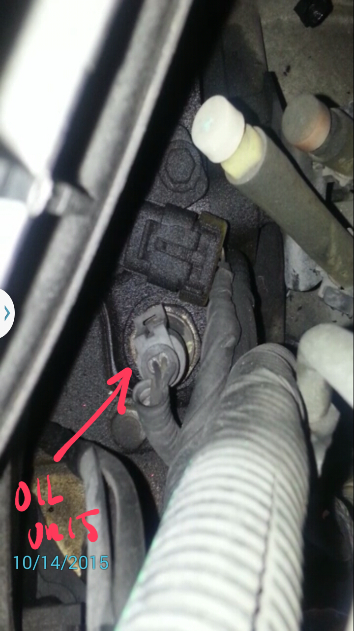

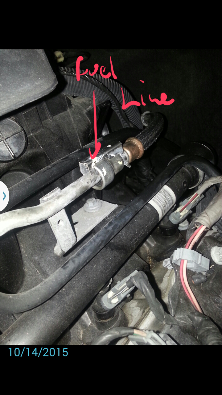

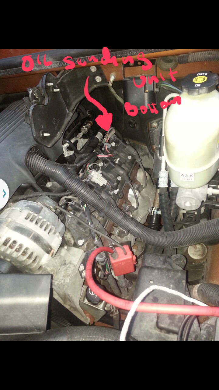

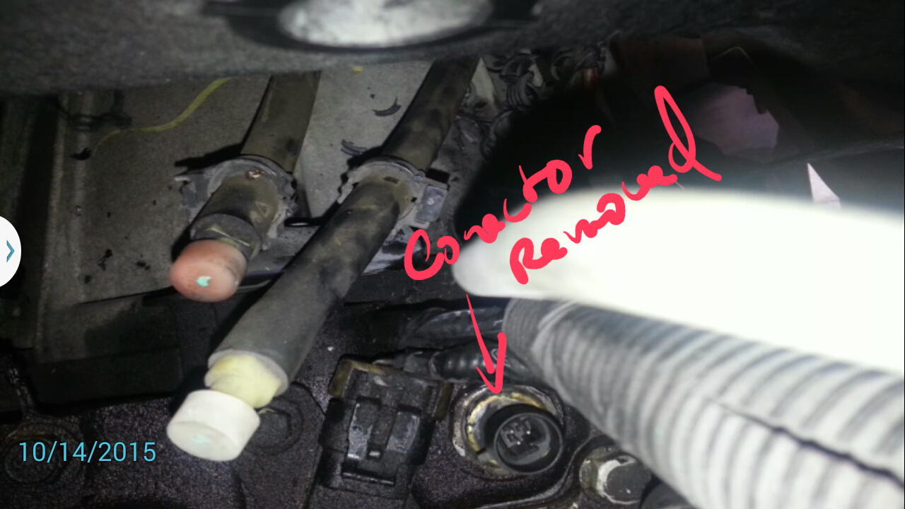

Oil sending unit bad / replaced
4 Attachment(s)
The oil sending unit got bad
Replacing this was not joke or fun . Took over 1.5 hour to remove the sensor and install new back
Best way I found was to remove engine cover , disconnect the fuel line then use a cell video while try to reach the plug
Be ready to get a few scratch on your hands
The sensor is all the way back and in the middle so reach this point is a nightmare
You are going to need a 1-1/16 deep socket , a few different measures extension. Lot of patience and a mirrow/flashlight or cell
The new(ACDelco D1846A GM Original Equipment Engine Oil Pressure ) comes ready to install
Torque 22 lbs
Attachment 8956
Attachment 8957
Attachment 8958
Attachment 8959
