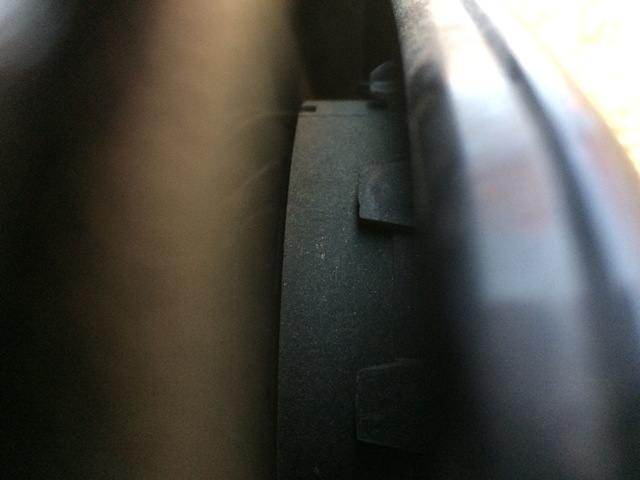

The mirror glass is attached to the motor, which attaches to the mirror housing with three Torx T10 screws. First step is to remove the mirror.
Pull the top inside corner of the mirror by hand out as far as it will go.
Attachment 9906
Look behind the mirror glass and identify the black plastic collar with the locking tabs around it. The collar is part of the motor, while the tabs are on the back of the mirror glass.
Attachment 9907
Gently start pulling the mirror glass out while prying one of the tabs off the collar.
