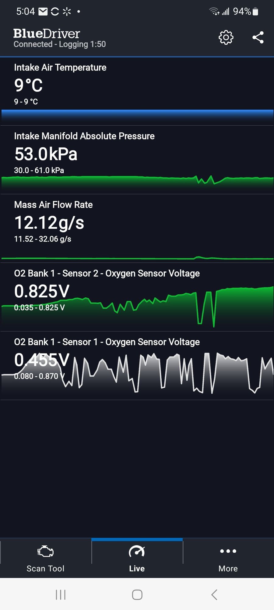

But what I did notice using my bluedriver is my MAF sensor shows around 10 to 12 g/s when starting and even after idle until the engine is warmed I know this is high, no errors on the MAF but I swapped it out with a A Premium part and got the exact same numbers, when I first tried to start it would not even catch just turned over and over, I disconnected theb battery and reset the CEL and it started but same numbers 10 to 11 on idle and up around 20 g/s when driving slow like 20 to 40 km.
I,ve looked at my B1S1 AND B1B2 voltage abd the seem to be different like .445 b1s1 and .830 b1s2 I'm thinking my cats are ok ? I can look at short fuel trim but I'm not sure what I'm looking for my sensor 1 always seems to show NA for either side B1 or B2. The sensor 1 on both sides seem to jump around feom either -6 to +6,

The flashing CEL is the PCM detecting a possible rich mixture that can damage the CAT's
Have you changed any of the rotating assembly like the torque converter or maybe the crank sensor, cam sensor?
You need to look at the long term fuel trims to see if they are more than +/-10%
Typically the PCM will detect a variation in crank acceleration and deceleration from the learned sequence and start flashing the CEL.
The airflow will start high when first cranked up then work its way down once warmed up, usually settle out around 6 to 7 g/s at around 550 rpm

I have not replaced anything like that, when I start it up cold it's around 10 to 12 gs MAF and after running for about 20 minutes with the engine temp at 1/2 on the gauge it's still the same 10 to 11 gs MAF.
Is there a way to look at long term fuel trim ? Or check the cam crank sensors etc to see if they are bad?
Is it possible to disconnect MAF sensor and run it to see if that is the problem or elimnate that ?

all those screen shots look good, MAF readings look steady not jumping around, I don't see an issue with the MAF
