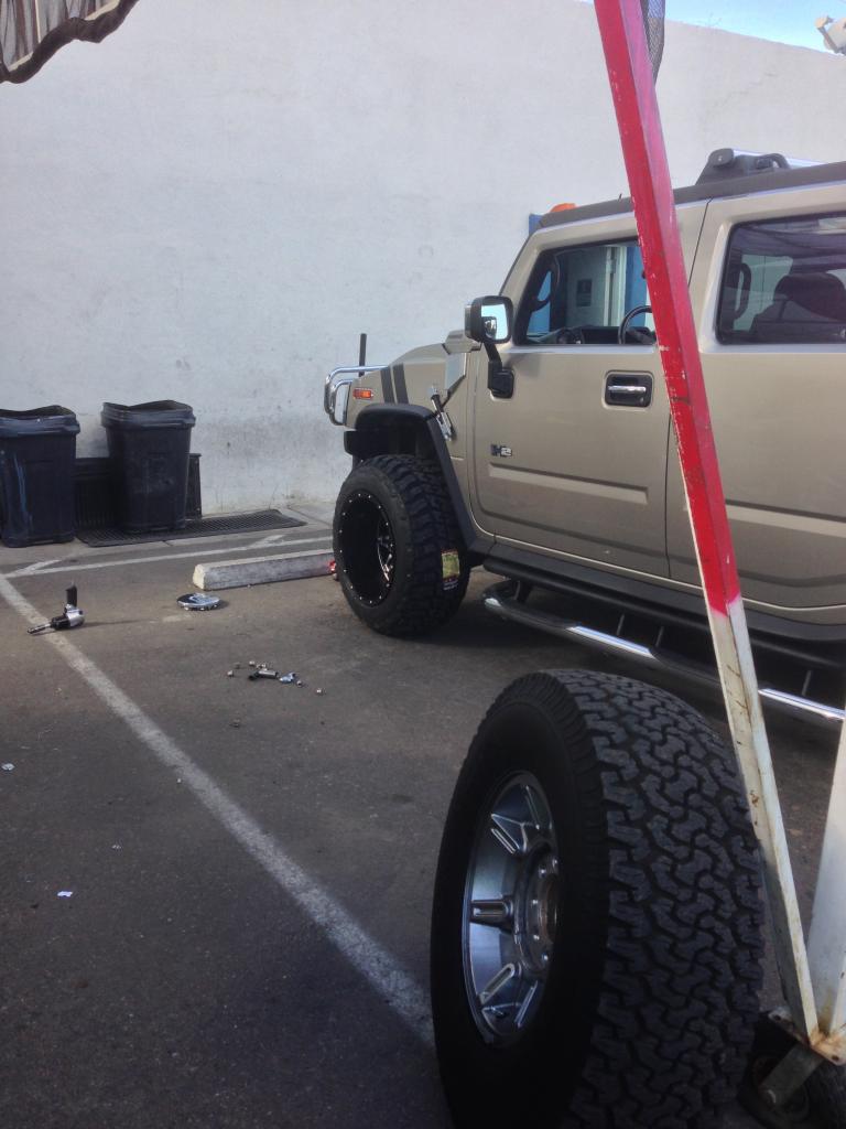

5 Attachment(s)
here are some pictures of them on. They don't rub
Attachment 13211
Attachment 13212
Attachment 13213
Attachment 13214
Attachment 13215

I have not got them yet just test fitted.
I have my doubts so I thought I would ask here for some more info.
Will these throw my front end out fast? Or is the hummer beady enough
To run these with no issues.
