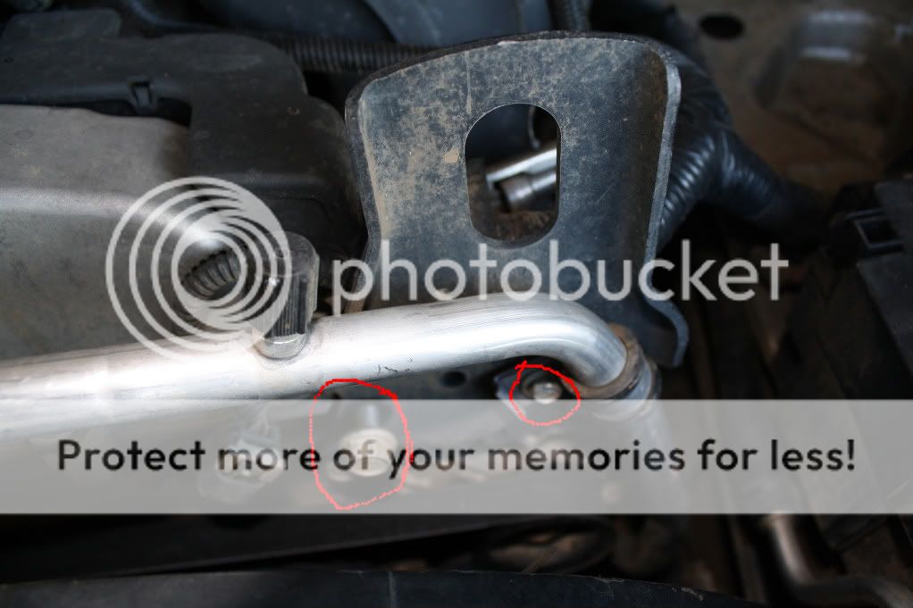

Ok guys my alt was on it way out and I didnt want to remove the driver side wheel, inner fender well, AND remove the A/C compressor. So after looking at it I was pretty sure I could get it out from the top. Here is what I did.

Step 6 Remove the front bracket from the motor. There are 3 bolts on the front and one on the back. DONT NOT BEND THE A/C LINE!!!!
Back bolt.
